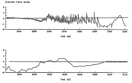

Jim Lux 2025/07/09 18:49
The field under a thunderstorm can be tens of kV/m even if there's no lightning.
So the antenna being "in that field" can put voltage on the coax.
But there's actually more subtle way - you have a high field, and that causes corona or sparking somewhere else in the system, and that corona sprays charge into the antenna system.
You can get an interesting phenomenon where you hear a buzz that changes in frequencies. That's from multiple things storing charge, and as the voltage increases, the buzz rate increases.
And of course, particulates can carry charge (dust and snow and rain all do it) - the thing about rain is that usually, for antennas, there's some resistive path from the antenna to ground that gets wet, and is a leakage path to discharge the charge. Airplanes don't have this, so they have to worry about rain caused P-static.
I guess the upshot is that you can get charging from "other things that are charged" near by.

Jim Lux 2025/07/14 07:01
100-200 V/m is the “fair weather” electric field. Near storms, it can get up
to kV/m pretty quickly, even without lightning in the picture. See
<https://www.missioninstruments.com/pages/learning/elec_fields.html>
![elec_field_graph.gif](cid:C17DBBB5-A779-4C98-AC80-440A21B632D7)
As to how one measures it - you use an electrostatic field meter - usually
called a “field mill”, which is basically a very high input impedance volt
meter with a shutter that alternately exposes and shields the measuring
electrode. The shutter is a disk with sectors cut out to match the shape of
the electrode under it, and it spins. That turns the measured voltage into
AC, so you can use synchronous detection and AC coupling, and it also helps
eliminate DC drift. (Just like chopper amplifiers in the days of yore).
